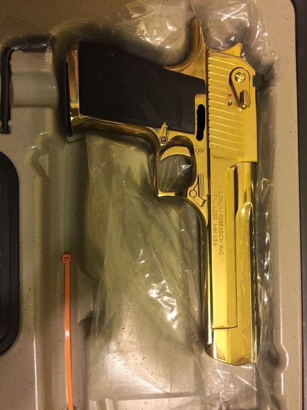

I recently purchased a Desert Eagle in Titanium gold. Now this is not going to be a everyday shooting pistol, so it sitting in its case for a month or two at a time without being handled will not be uncommon.
My question is is there certain precautions I should take when storing it?
As of now I lightly oiled the hole gun per magnum research exterior care instruction sheet. It is in the case it came with inside a zip lock bag with as much air taken out of it as possible.
Is this sufficient?
Here is a picture just because :D

That yellow gold color is a TiN (Titanium Nitride) "finish" applied to the surface of the metal. It is a very hard, durable coating, typically found on drill bits. Also with anti-corrosive properties. Unless you have a rusting problem with other metal items in your house, I would not do anything special .

CCIman wrote:That yellow gold color is a TiN (Titanium Nitride) "finish" applied to the surface of the metal. It is a very hard, durable coating, typically found on drill bits. Also with anti-corrosive properties. Unless you have a rusting problem with other metal items in your house, I would not do anything special .
I was thinking along the same lines. Leave it be. Putting oil or whatever will result in a wet, "soiled" appearance. I won't even put oil on my brushed stainless, and bead blasted firearms.
